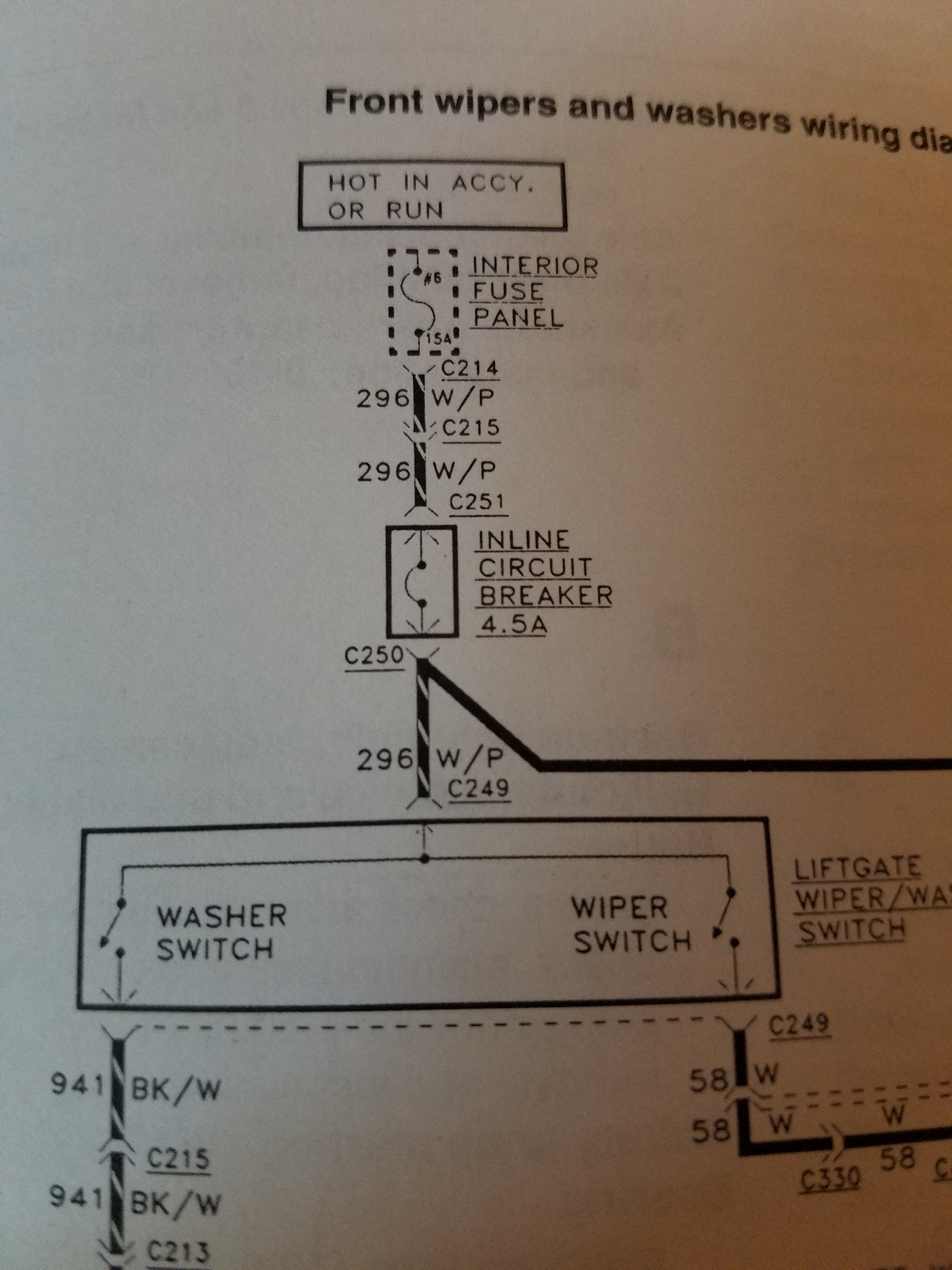

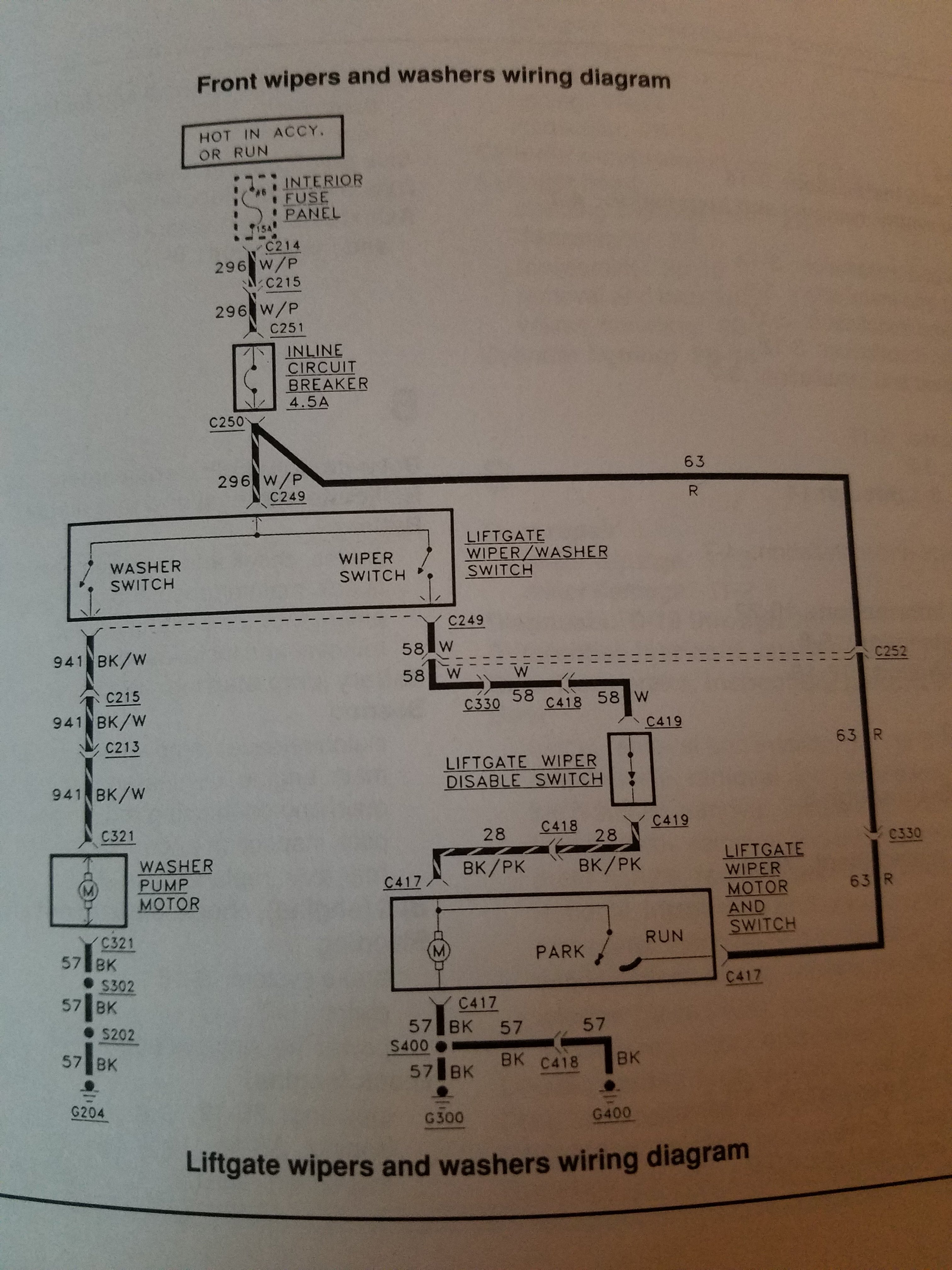

Really trying hard to get my rear wiper/washer to work.
I have replaced the switch. I have replaces the wash reservoir and motor.
I have bypassed rear glass safety switch.
I hear nothing from wiper motor or washer motor.
I have checked fuse. When i check for voltage, i am only getting like 60mV. Should i be seeing 12v? Sounds like a bad relay or module to me.
Questions:
1. Is there a rear wiper relay?
2. Does the GEM module control the rear wiper?
Thanks a bunch yall
