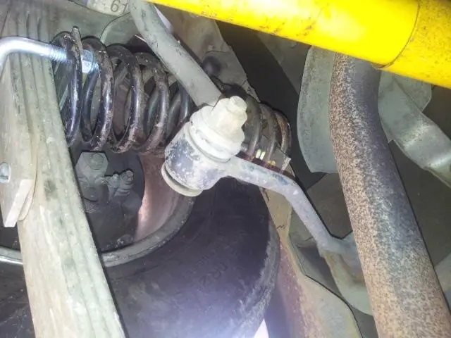

I had a pair of coil springs from the rear of a Lancer (Mirage) that I clamped on to the flat area of the leaf springs behind the axle and clamped the top to the chassis rail.
Instant 2 1/2 inch lift and the spring rate feels the same.
The same? I figure that the leaves don't contribute to the springing until they are compressed to the height that they were before I installed the coils so in effect I have the spring rates of a 1994 Lancer which works surprisingly well.

How about a pic?
I have a feeling it's gonna look scary
It is a bit, it's quite safe but a bit kludgey.
This isn't it's final form, this was more a proof of concept.

How about a pic?
It won't be staying like this, Im going to mount the VW springs on top of the axle using these or something like it.
