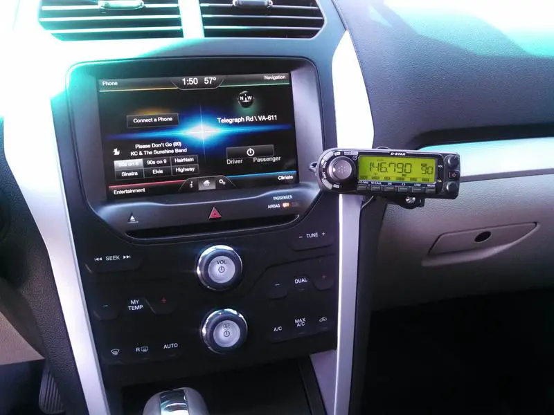

That looks VERY good!!! Did you also use ProClip to mount the control head?
Panavise mount that bolts under the screen bezel. Then attached a universal GPS mount that has swivel adjustment.
The ICOM 880h control head has a detachable metal mounting plate with magnets on the back of the head. Attached the mounting plate to the GPS mount with some 3M double sided tape. The head can still be removed to stow out of sight.

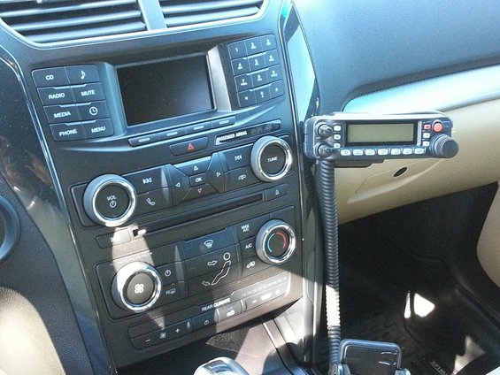

I now have the control head of my Yaesu Ft-7900 mounted to the dash on a Panavise mount.
I gotta get to work on a place to mount the mic. I'll probably use an extension cable to bring it over to the driver's side of the center console.
Today I mounted the main body of the radio in one of the cubby holes under the police cargo platform (another mod I did).
And stuck a Larsen KG-2/70 antenna to the rear side glass.
I haven't tuned the antenna yet, but did hit the cross-town repeater on low power (5 watts). Reception is very good too.
I have the speaker under the driver's seat for now. Works okay down there, but I will have to see if I can't find a better place for it.
