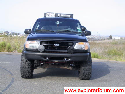

So does this look capable enough?
Yeah, I've done some mud, some fording, and some climbing with mine, but I do have a V8 and the factory LS. I did wish that I had driven to GA with my Mud Terrains instead of the on my Pirelli Scorpion ATs, but the Pirellis pull a trailer and handle Atlanta traffic much better.
