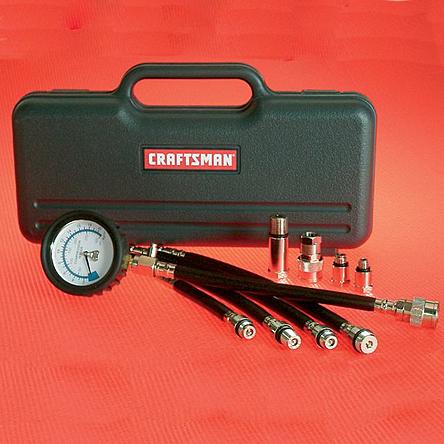

Just a heads up a normal compression tester kit doesn't include an adapter to fit the 3v plug holes. You have to buy it separately.
I wonder if AZ would have the right fitting in the tool loan program. I have a Craftsman compression tester and it has many adapters

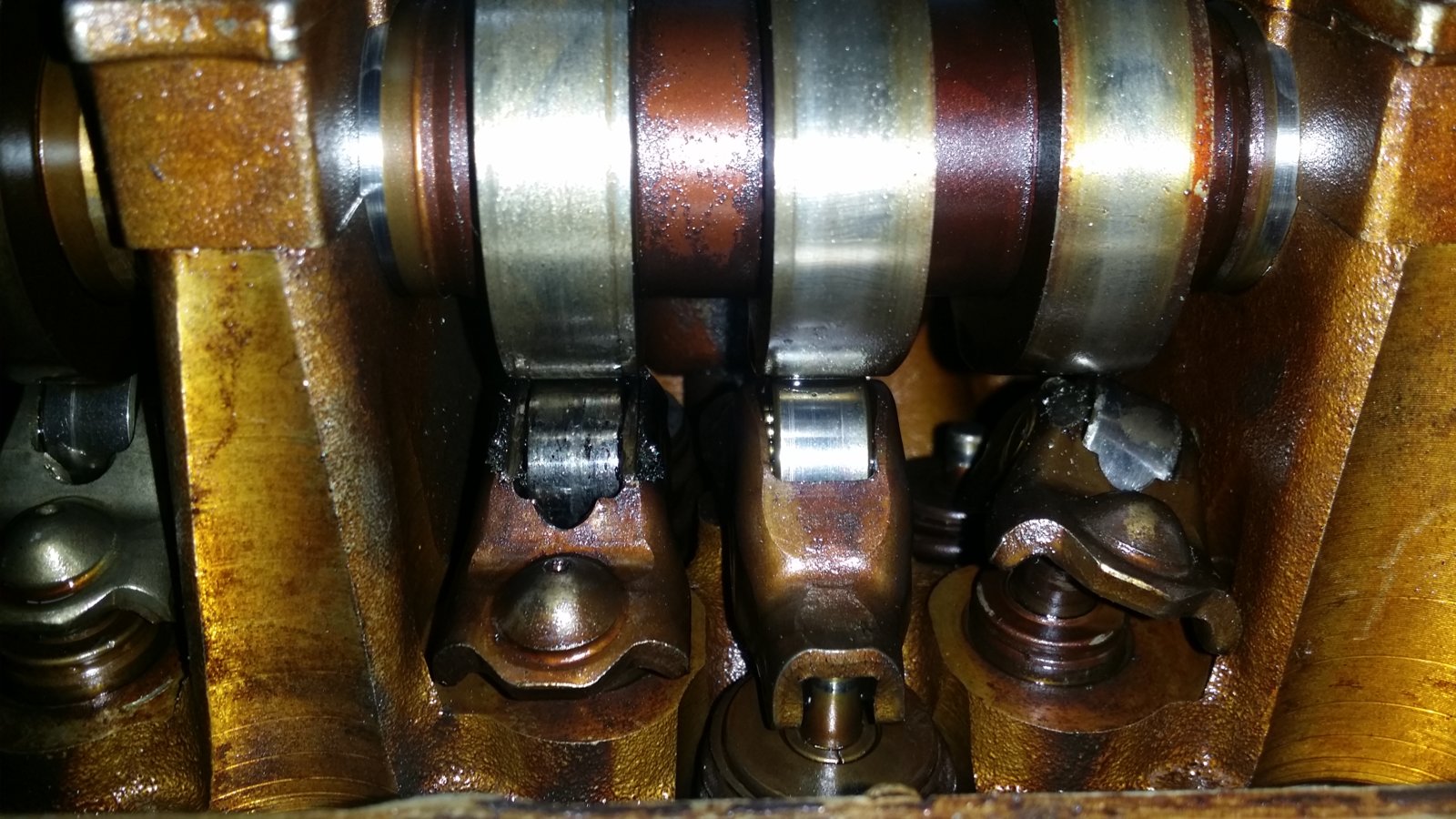

Here's a pic of a f150 w/165k I did about 18 months ago. Follower on left center bearing is heavily worn. Follower on right center bearing wore just enough to kick off the tip of the valve and wedge into the cam (unlucky situation). Ended up having to swap the head and #1 piston from valve damage. Hopefully not your issue but it's possible. This is a pic of a 5.4 engine but it uses the same heads/cams/followers ect.

What would you say caused that wear and failure ? Dirty oil ?
I completely forgot these engines use the roller bearing cam follower and not regular rocker arms. It didn't occur to me even though you asked me in an earlier post, until I saw your picture of the follower failures on these engines. When I pull the valve cover off this weekend, if I see a follower just lying in there, would there be a way to tell if it caused more damage like in your picture without pulling the head?

Combination of exteneded oil change intervals and hard miles. The truck also has 37" tires putting an extra strain on the engine.
I had an 09 f150 in the shop that had a bad follower about a year ago. It had nice clean oil and only 80k. Guy traded it in because ford priced him a new engine instead of fixing follower. It was a very loud tap though, definitely sounded worse than it was. It had some scraping on the edges of the cam lobe but wasn't bad enough to replace. Threw a new follower and lash adjuster in on that 1 cyl and it ran like new.
Since your truck runs still and doesn't make any crazy noise I'd assume the valve / pistons are good. They can definitely kick out and cause damage. I haven't seen a broken valve spring but it's always possible too as I've seen it a few times on the 4.0 v6.
Ford racing sells the 24 lash adjuster and follower set for around $300. It's the way to go if you have to tear into it. They are the same ones as stock, just at a really good price for the complete set.
