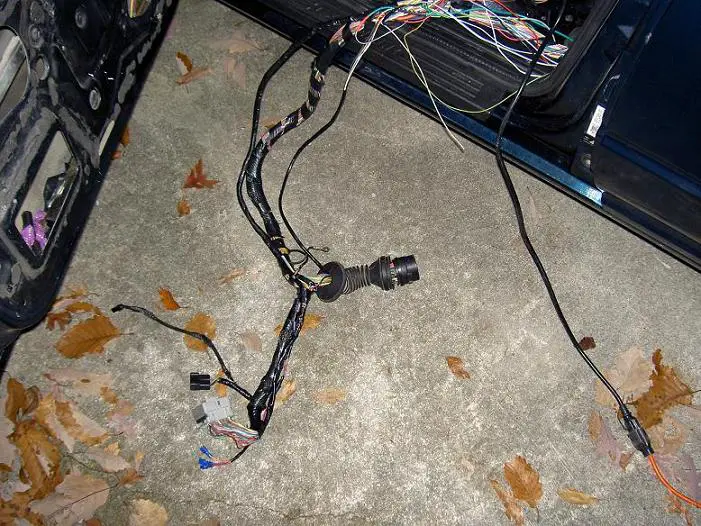

Here is the body harness laying next to my LF door. Notice the large gray connector at the bottom, with the black one above it. That gray one is the main dash connector, it sets very near and behind the fuse panel.
The black connector runs up the "A" pillar, it's right at the top of the dash on the pillar. Hopefully all of the Explorers have that same connector, it can take about 12 wires. There should be a mating connector and harness which leads up to the roof, mirrors and console. Those short harnesses should be very easy to get due to their short length. I would want that to go with the mirror when you add it.

that would be the way to go
