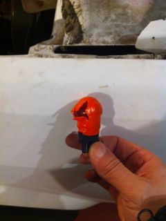

My best solution to date were the red condoms I used to find in AutoZone. They appeared far from a quality solution, but slip them over a standard clear 3157 and they worked just like having an OEM setup! However, they did fade slightly, and then crack (see pic below), which would leak out clear light in certain spots of the lens, but it had a better life expectancy than colored-glass-bulbs, especially for the price.

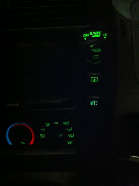

I also tried one of their $2.99 Type A NeoWedge LED (for the rear-defroster & fog light switches) and $3.99 Type B Tall NeoWedge (for the headlight & 4x4 switches). I went with their non-SMT/cheapest, lowest modeled, "dimmest" ones ... the ones they use the least amount of flashing stars and "1 billion % brighter" ads on. YOU CAN OVERDO LEDS - they can get incredibly intense, which does not do dash lights justice. I wanted these to fit in and look exactly like stock and not blind me - so I wanted to get the mildest ones.
The Type A is perfect in the rear-defroster & fog light switches - it has a perfect green color and is the perfect brightness. It really shows how faded and dim and yellowish the OEM incadescents look on the other switches, so I will work on replacing those too, the rear-wiper switch will require a custom set-up. The fog light switch is the one with the LED, but from the picture, it looks like the LED is blue-green and the OEM lights are perfect and bright, but that's the camera.

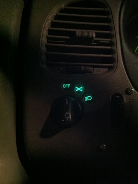

So I'm going to try a Type B Short, so I moved the Type B Tall (reverse my mod) and put in the Headlight switch (where the OEM's bulb is actually taller than the Autolumination's). The LED is a little too bright and focused, so it has the same problem, makes the center of the Headlight switch label a little brighter than the edges. I put four layers of Magic Scotch Tape over the LED (don't have to worry about heat anymore), which helps dim a tad and disperse the light a little better.
