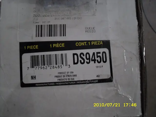

Just out of curiosity, whose shaft did you use? I put in a reman from NAPA (A-1 Cardone)...
I used a "Fenco DS9450; Length 23; Type A18" from Advance Auto Parts with 20% off online for $160 total. Actual length was 22 3/4" like I said above. Interestingly enough I have the invoice right here and AAP's website does not list it anymore. Instead they list this wrong part which has the part number DS9451 and is an inch too long.
Edit: Here is a picture I took of the box mine came in:
Link to larger view.
