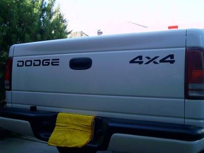

Just wanted to post some pics of the emblems i removed off my truck today. I took off the ones on the Tailgate , Driver and Passenger doors. I like the look. What do you Think?
Before

Very nice, now just change the front Grille to a Ford one and you're getting there ;)
Looks nice and clean. I think you should add a "Serious Explorations" sticker across the windshield though, it would match your new Ford grill nicely. :p
Yeah it was easy to do. I used a Hair dryer and a plastic razor blade to take them off. I used Goof-off to remove the sticky crap then waxed it. Took me about an hour to do all of them.

Looks great! Removing the decals and emblems is one of the easiest and cheepest (free) mods that really smoothes out the look of a vehicle.
