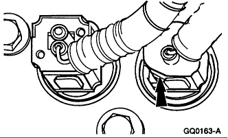

During the Uwharrie run this weekend, the coolant needle on my gauge cluster went WAY down below C and stays there and every so often it pops back up and works sporadically.
Ok I replaced the temp sender. No good! Still doesn't work. How do I test the wire going to it?

hey man, i dont know if this might help you out but here goes......i have a 92xlt and hat the same prob....you might have to replace the actual sensor to the cpu, and not the sensor to the gauge, i did that and everything is all good, the sensor costed 22 bucks.....look in the it, on the 4.0 6 they are right next to each other.......rob
I know it's not the thermostat because it completely bottoms out the gauge.
I thought about the other sensor, but arent they completely independent of each other?
