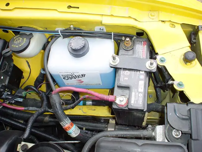

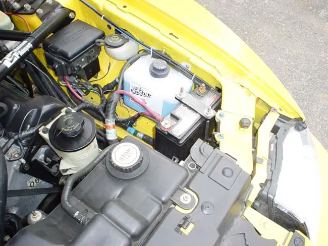

danlong said:
not to mention the overflow and w/s washer tank is in the way on that side.
Hehe, not really...:D
mrboyle, thank you so much for actually listening to what I was saying, thinking about the question, and replying with an answer rather than trying to talk me into doing something different that defeats a large part of what I was intending in the first place!!!
huskyfan, I can't move my w/s washer tank to that side, as I already stated, I have a rather large cone filter sitting right where the battery used to reside.
I'm not trying to come across as an a--hole here, I just feel like many people refuse to try and think outside the box sometimes.....
On a side note, I found a battery made by Interstate, part no# MTP-91, that has a vent tube that can be routed outside the vehicle. It's made to fit late model BMW's (thanks again, mrboyle :)), has a CCA of 700 (maybe 750), and costs about $95 with a 85 month warranty. From my measurements, it should fit almost perfectly where the factory sub is intended for.

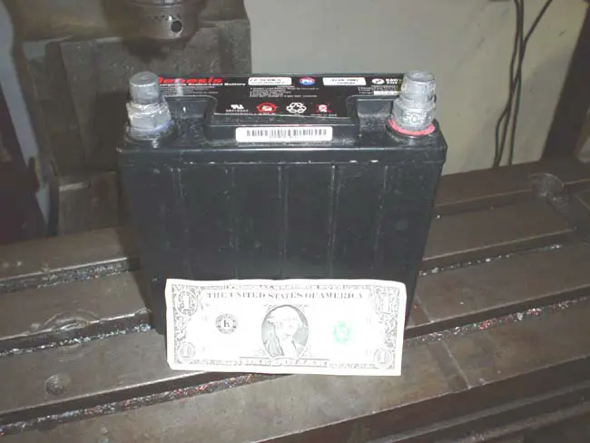

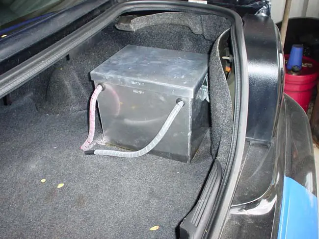

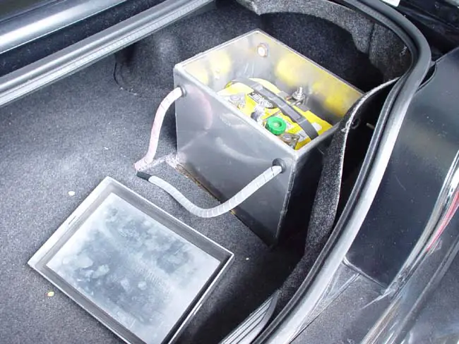

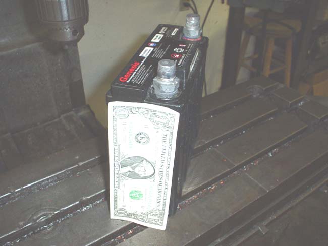

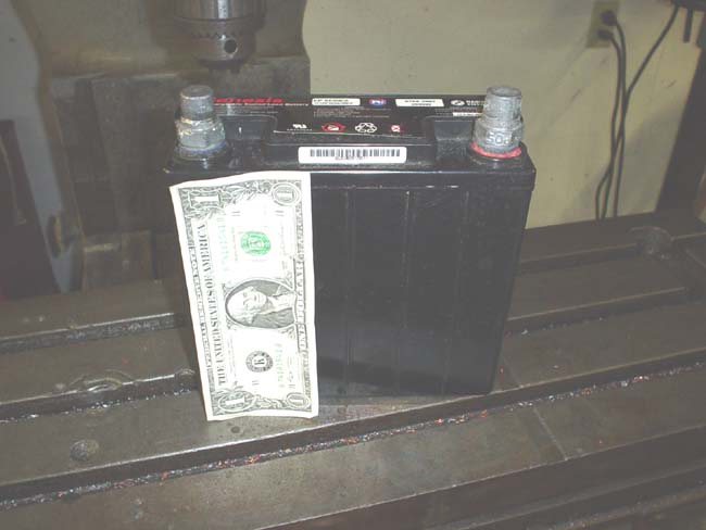

Try this on for size, correct about the Optima batrteries need ventalation and you can mount them in the trunk but the case needs to be vented outside the vehicle. (just bought a new red top for $35)
"Thinks outside the box" so what makes 12 volt and has loads of cranking amps and can be mounted inside a vehicle that won't cause any ill effects?
Well what is kept indoors and is charged/used inside?
Wheel chair batteries!!!!!!!!
Now they won't support a high output stereo system, but if you want to relocate that puppy inside the vehicle and to the back without any ill effects this is the key!
But they will start you vehicle and only wiegh 13.5lbs. recharge the same way regular car batteries do and can be mounted in ANY confguration, upside down, sideways, ETC.
And they wiegh so much less, great for racers/wheelers, looking to lighten the load.
Future write-up on the install into my Navajo.
That's great! I wasn't familiar with those, nor had I even thought about them. Unfortunately, I want a lot of reserve power, as I'll be loaded with electronics (A/V, lights, alarm, possible carputer, etc) and don't drive my truck everyday since I have a company car.
My concern isn't even about the battery though, I asked a question about wiring a battery in the rear, and pretty much all I got was people telling me other places to put it..... but thank you very much, I look forward to the write-up!

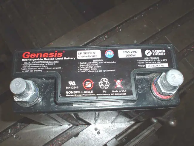

read the top of the battery in the pic - DO NOT charge in a gas tight container.
I never said put it in a box!
But you'll have ppl charging these in thier house.
And most ppl that relocate thier batteries to the rear of thier vehicle don't put them in air tight boxes, they mainly use the standard battery box for a boat!
This is the safest way to relocate a battery into your vehicle.
"Orientation/Placement/Transport- Due to the products' mechanical design, GENESIS can be mounted and operated in any position, an atractive feature for less accessible areas.
GENESIS offer UL 94V-0 non-halongenated flame-retardent packaging, thus allowing the mounting systems in sensitive areas and human enviroments.
http://www.trolleyenterprises.com/cd/docs/section10_batteries.pdf
Non-sealed lead-acid batteries contain a liquid sulphuric acid electrolyte. If the battery casing is split, the acid can leak out. In batteries is it quite concentrated and will easily burn the skin and clothing. Therefore, the RW rules state that liquid-electrolyte batteries of this sort are not allowed. Appropriate SLA batteries are the only type allowed (apart from the much more expensive NiCd or NiMH types).
All lead-acid batteries produce hydrogen and oxygen during the recharging process. This production is increased if overcharging occurs. Sealed designs cause recombination of the oxygen at the same rate is produced, therefore eliminating the explosive mixture. Hydrogen which is produced will permeate plastic containers and as long as the sealed battery is not in a sealed small area, the hydrogen will harmlessly dissipate into the atmosphere. It is always good practice to allow for ventilation even with sealed batteries because of the possibility of a charger failure causing abnormal charge rates. If this happens, the battery will vent to prevent pressure build up. Another precaution is to prevent short circuits of the battery terminals. This can cause high heat and potential fire hazard.

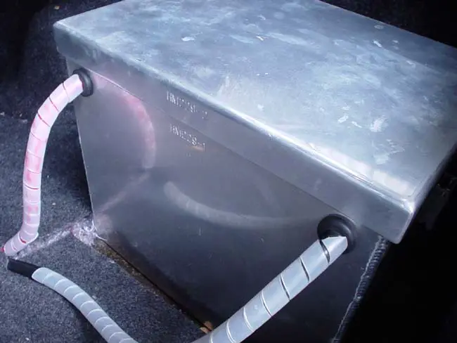

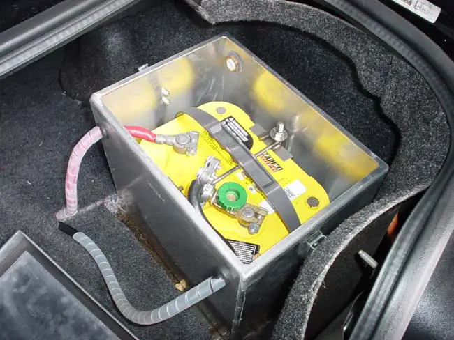

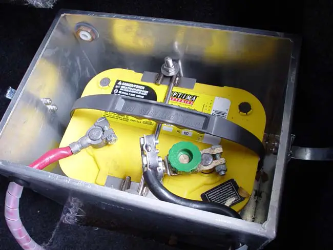

:cool:
