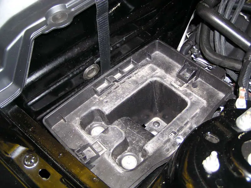

Take the battery out of the tray, and remove the tray from the vehicle.

Remove the space saver tab that slide out of the battery tray and cut down the ramps at the far end for the larger intercooler tank
Locate and mark where you need to cut the tray for the drain petcock on the tank
And remove this insult for a cooling tank and pitch it in the trash!!!!!!!!!!!
