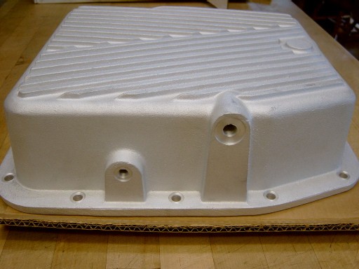

Where are these "ports on the side of the trans"? If they're not in the trans fluid pan, then you're not getting an accurate temp reading of the overall fluid.

Not 100% true - the fluid is moving quite rapidly through the transmission, and therefore is a uniform temp. Granted, the torque converter produces most of the heat, and the coolers remove some, but it's a 10 degree difference at most throughout the circuit.
Those ports are for testing. The AOD's have three, maybe four of them. One for each of the different circuits. They are on the passenger side, just above the pan rail. They are all 1/8" FPT. Good luck,
