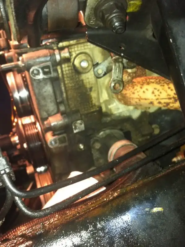

Here is a pic of where the Power Steering pump bolts up at. I have removed the pump. There are not enough bolt holes! Only the two bolt holes on the left on the timing cover line up with the Explorer pump. I really have no idea what engine block I have. It may be a Mustang block, heck it might be a Mercury engine. I hope someone can recognize the block from this pic.
There is probably a bracket that is missing then. Check fordparts.com to see if you can find the bracket. Aluminum blocks are explorer engines.
