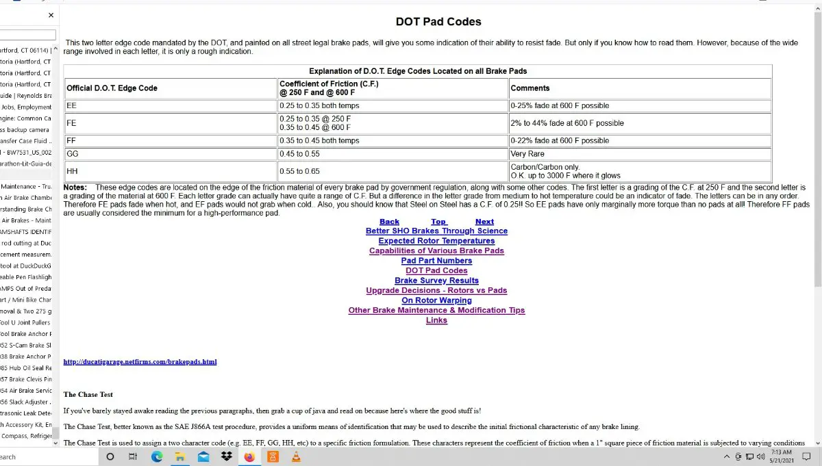

Like J C brought up with ceramic I would look for a top quality name or semi metallic which was the standard for years in severe duty use with long life and excellent stopping power. When I was working on H-D trucks some of them would be overweight at times and needed an upgraded friction lining due to brake fade. Your service can be compared to school bus with juice brakes and refuse truck with frequent stops where a semi met pad/lining is recommended.
