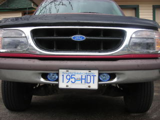

MadExplorer, here's your pics!
Keep in mind that mine are mounted beside the license plate (see below). If yours are mounted higher the light will probably travel further. All pics were taken from the driver's seat
This is just the driving lights
This is driving lights with low beams
This is driving lights with high beams
Hope that helps. If you buy the fog lights, let me know how they are. I might get some for highway use.

I truely thank you for the pictures as it really helps me decide now what to buy.
Wow that is bright for sure just the lights alone blow away my low beam distance. The older Explorers suck for low beam distance once the headlight plastic starts to diminish over time.
I may still get the square ones which are blue leans and 55w as well, i may not get them for sometime yet as something has come up now and i need to spend money of it before i do the lights.
Hey no problem...they are bright, I could basically use them as headlights if they were aimed right. As for the light bar, maybe a cheaper (and easier?) alternative would be something like the bracket found here:
http://www.explorerforum.com/forums/showthread.php?t=83401
I don't know if the 1st Gen bumpers mount the same, but you might be able to adapt thatidea to fit yours.
