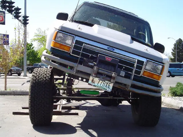

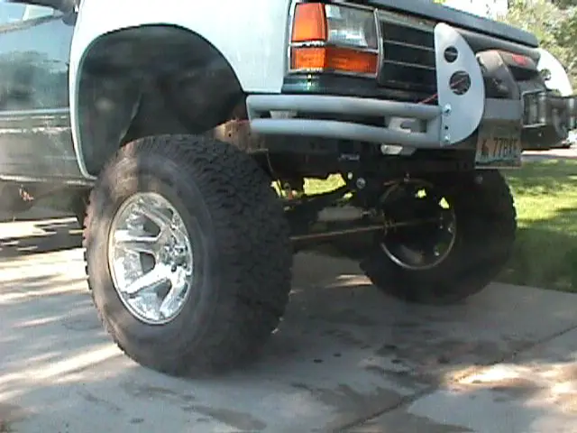

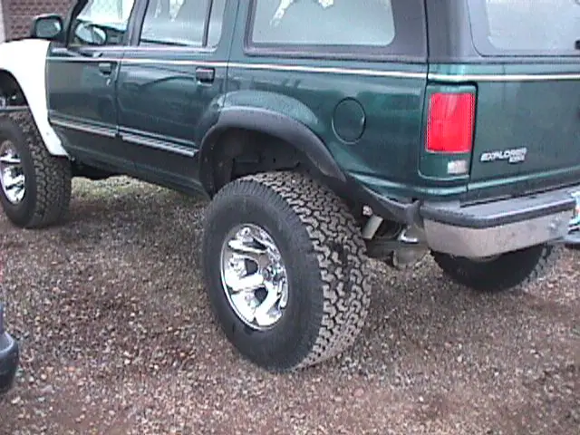

You could go either way with the BFGs. The muds do wear well on the street. I used to be a BFG dealer (many years ago) and guys would typically get 40k+ miles out of them. Here's some pics of my 35x12.50R17 BFG AT/KOs on 17x10" rims for your reference. I've had them two years now on my daily driver and hardly any signs of wear.
The first pic is two years old (prior to SAS and fiberglass). The second pics is three months old and the third pic is a year ago.
