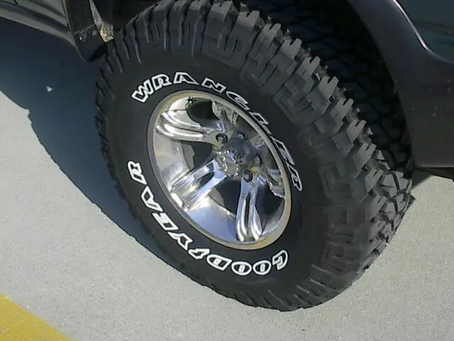

I had 31" BFG AT KO's for a while and just recently put on some 32" MTR's and they are much better on wet pavement. I STILL have not got to test them off road yet. But I have only heard good things about them. I will be testing them soon in the sand at Silver Lake.
Here's a pic of it.

Those are great rims. :)
Two questions about the 32" tires: Did you have to do the body lift to get them to fit or do you think they might have worked with only the TT/Shackles. Also, do they need a 15 x 8 wheel? My stock teardrops are 15 x 7 so I don't know if a 32 x 11.5 will fit on them anyway.
Oh, and this might throw me out of the 32" range anyway... I measured the other night and have about 3/4" of sag in the rear drivers corner. I've done some searching and it looks like it might be correctible when I adjust the Torsion bars on the front end. If not.. I may use an add-a-leaf.
There is no way mine would have fit with out the body lift and aftermarket rims. Even my 31" fit great with stock rims before the lift...after new rims...they rubbed. The offset makes a big difference. I'm not too sure id you can put an 11.5" on a 7" wide rim.
