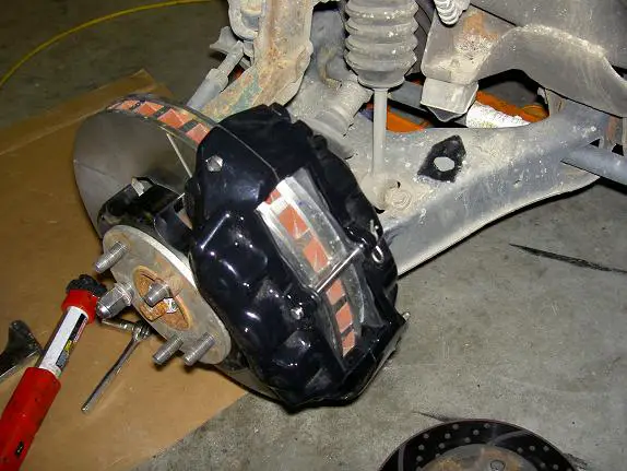

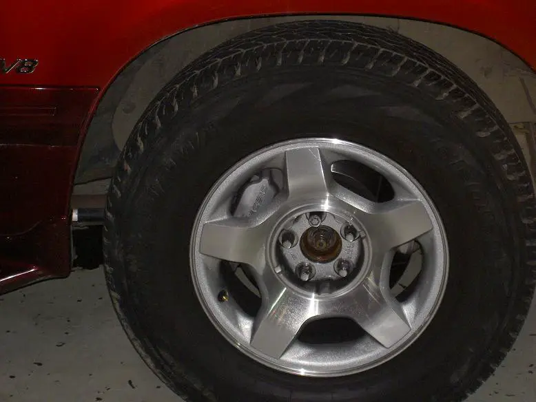

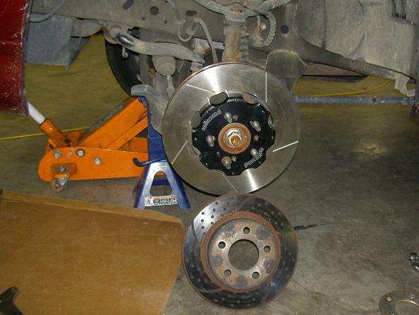

Note that these big front brakes only work on 4WD/AWD 95-01 Explorers. I have not finished it yet. I just got the latest brake bracket back from a machine shop. I still need to finish the brackets, test fit, and install.
My first combination was a stock Cobra rotor, and 65-82 Corvette caliper. Unfortunately the rotor offset is far different from the Explorer(0.350" versus 1.450"), so a two piece rotor is required. Do know that all two piece rotors cost about $250 minimim each. I chose a 1.160" offset Wilwood hat, and a 12.90" x 1.25" rotor.
The good news is that my first fitting shows plenty of room inside of 16" factory rims. I have yet to learn if the calipers are the right match in brake power. They will not be too little, as any late caliper would be(Cobra(PBR)2x38mm piston). My estimate for cost is hovering between $1050 and $1100 at the moment. The calipers have to be clearanced slightly for the rotors. I will start a thread if/when I feel they are worthy. Regards,

The stock 95-01 Explorer calipers are really very good, in all respects. I will wait until I discontinue delivering mail with my Mountaineer, and see how normal pad life turns out to be. If I actually upgrade my 99 mail vehicle, it would get my first combination, pictured above. Most OEM 16" Ford wheels work with them, the Sport Trac wheels do not, I have snow tires on them now.
