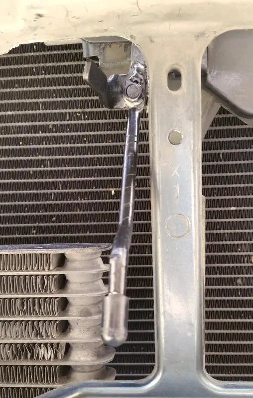

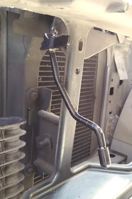

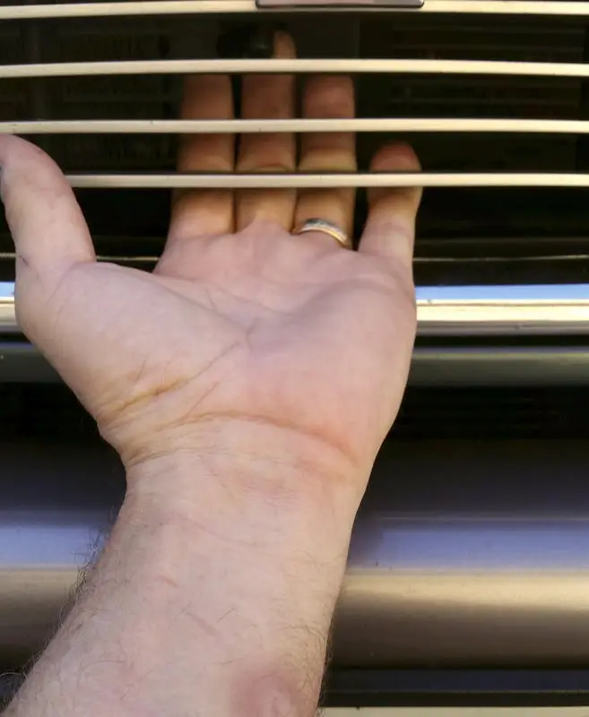

I was searching for this topic as I too have the same billet grill on a '97 Sport that I purchased last year. I wanted to add a few pics to show anyone that runs into this issue just another variation of what can be done. Here are a few picks of the hack that I implemented on mine. I used an old 1/4" brace that I found lying around the garage. Mild-steel rod from a hardware store would work just as well. I drilled a small hole in the existing lever and screwed this scrap bracket on to it, then added a few tack welds. I pushed a little vacuum plug onto the end and wrapped it with black tape. That's it.
Now I can reach down just below the bottom of the grill where there's ample space for my hand and fingers and move the lever-extension to release the latch. Hope this helps someone that might run into this again.
