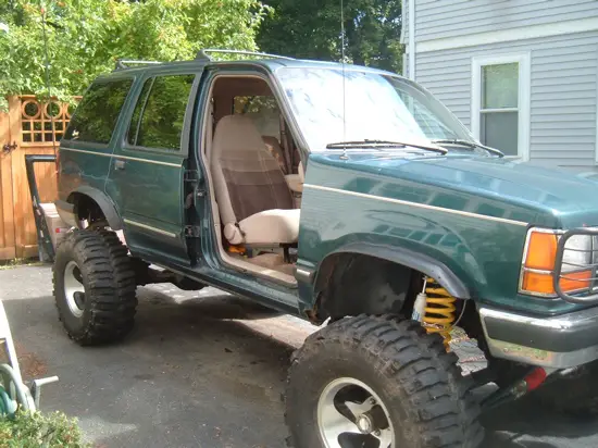

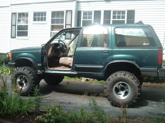

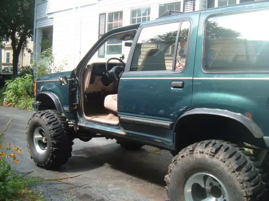

I've been elite for a little while now, but I just wanted to echo how helpful everyone has been on this site. I'm registered on a lot of other enthusiast forums, but this one was really the only one I've felt obligated to contribute to. Below is my truck BillyBob aka "The Redneck Limo". Without the knowledge of the members of this forum, this truck would not be what it is today.
Specs:
92 XLT
151xxx
Rebuilt Auto
Coil Sprung D44/9 Inch
F150 Steering box
Double sleeved drag link
Yukon 5.13s
Custom Driveshafts
Spicer U Joints
BDS Shocks
Custom 3" extended shackles
Rough Country AAL
Braided brake lines
Frame has been ground and painted
Trimmed wheel wells
35x14.5" Boggers
Midland CB/PA
Class 3 hitch
No blocks, no spacers
I just took some poser pics, so please enjoy. Thanks again everyone

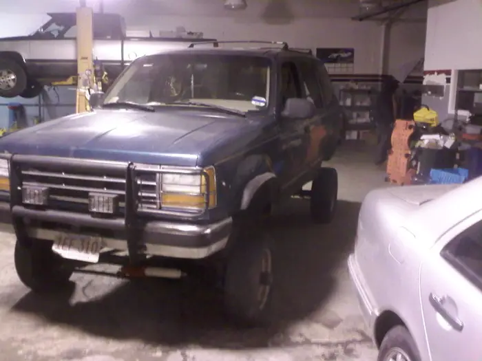

inspection time lol
gotta love MA :rolleyes:
I have a set of stockers that i roll on every now and then. I cant fit on any allingment machines unless im on stock rims/tires

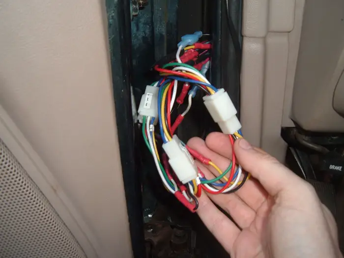

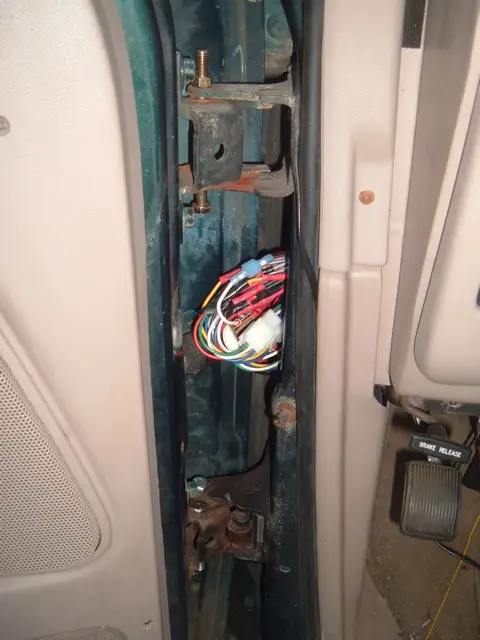

So...had the day off from work...got bored...took my doors off. well, i got the driver's side done, taking care of the passenger side when i can get some more quick disconnect wiring harnesses. it actually came out pretty good. Used three individual 6 wire quick disconnect harnesses plus a single quick disconnect for the smallest gauge wire. 19 wires run to the driver's door. Replaced the hinge pins with grade 8 5/16 bolts. they're a little loose on the hinges but not bad. The sleeves were rusted to the hinge pins so they had to come out along with the pins themselves, so the door doesn't line up perfectly, but it's close. as far as the wiring, all the connections were good on the first try. so yeah...thought I'd share
EDIT: Uploaded some pics of what I did. It looks like a massive cluster f*ck of wires but you can see the three quick disconnects I have everything running to so it isn't that bad. Good, bad? What do you all think? And I'll take some more pics when I get the passenger door off
