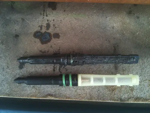

Just to give you an idea of how nasty black death is..
This is our orifice tube after 1 year on a system that is suffering black death.
Black Death on a Variable Orifice Tube by maniak_az, on Flickr
