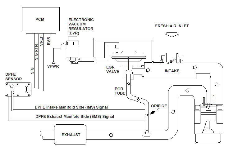

As for the EGR issue, have you searched this site? Search for "code 327 from hell" and you will see what I went through. I agree that it's most likely the DPFE. Whatever you do, make sure you buy the new part from Ford. There is an upgraded model available (comes with a new adaptor that you have to splice in). I used an aftermarket one, got a few weeks out of it, then had to go with the Ford part. Don't waste money like I did. BTW, correctly troubleshooting the EGR system requires a vacuum pump (I skipped this and went right into part-swapping).
