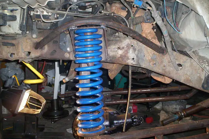

get you some spring clips bro or you will go around a corner and out goes the spring will slide over in the bucket till it catches your bump stop. Also isnt the 6" bumpstop in the coil gonna hamper your compression travel? I think you would have better luck pulling some bronco buckets off a junkyard truck and using them up top with some J-hooks to hold the spring from falling out.

ok now they won't fall out, but won't they rattle like hell like that?
this is how jeep cherokees and grand cherokees are done
Looking good. Did you not space the buckets out from the frame? You need to do this about 1.25 to 1.5 inches on both sides or your coils will sit like this / \

they wont rattle with the waight of the car on them. but you might need some sort of stap
cherokee's and all coil sprung jeeps have a bucket with a indention that the coild seats into... not a flat plate.

Well i just got done welding and i burned my self with the tip twice lol. all brackets are welded up, what do u guys think of these bars above the coil bucket. I will mount my shocks to these.

man, you're making good progress! You'll be done in no time
