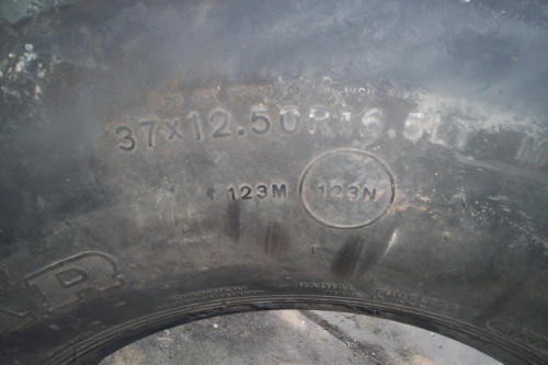

and tires and my axle painted just waiting for new nuckles
What kind of tires are those?
where the heck did you find those!?!?! I would love to have those tires!
:thumbsup:

and yes froader there off hummers
