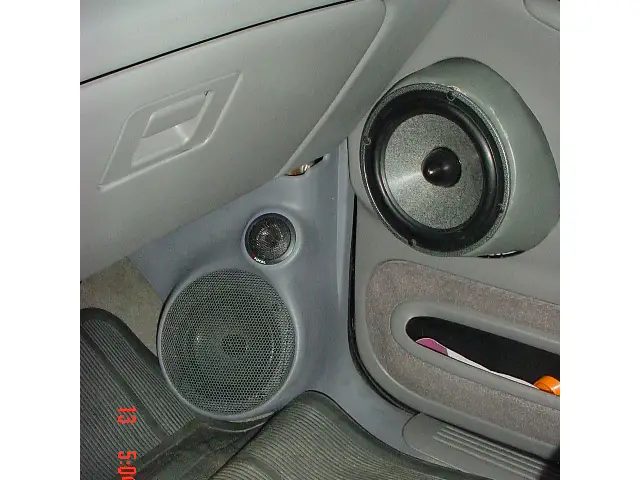

Very similar setup
Alpine makes some great stuff. Here's the direction I went after lots of research and shopping and testing. Those Focals are unbelieveable aren't they?
I've got an Eclipse 54410 CD deck, with the Eclipse 5083 8 disc changer in the console.
Focal 136Ws Utopias and the Audiohm 6W Utopias to make my 3 way set-up (built the pods myself)
No rears whatsoever
Macintosh 4x100 MC400 for high-end power
JL 500/1 feeding a stealthbox with a 10w6 DVC, like 1/2 gained.....
1 Farad Cap, Audiocontrol 24 bit crossover, all under plexi for protection.
Sounds sick, and when the doors are closed, you can barely hear a sound outside my truck thanks to covering it in Dynamat Xtreme. Here's a pic of the front setup. There are some more in the Elite section of the "images" area under

I Like burnsie's setup too. I am really like those 3-ways you got thurr and wish I had the patience and money to do some of my own.

Hey Karl,
Do you loose the functionality of your parking brake with those speakers in the kick panel ?
I bent the parking brake
Not sure if there's a pic up o not, but I bent the brake so that it clears the pod. When it was only bent partially, and wouldn't quite clear, the brake gripped only when the pedal was pushed as far as it would go. Didn't like that little nick on my pod, so I bent it some more for clearance.
You can also shorten the cable so that it grips immediately (best solution), or I've seen people build electric motors which engage the parking brake (too expensive for me).
