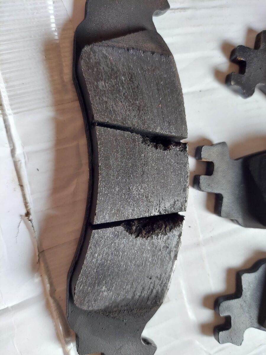

I went and bought a new caliper, and a rotor/pad kit at Napa, installed it all, bled it out again, and bang! We got brakes. Pretty decent brakes to be honest. The missing slide pin bushing was definitely the main culprit, be I found another issue that while it wasn't causing my soft pedal, it was going to cause a serious issue soon.

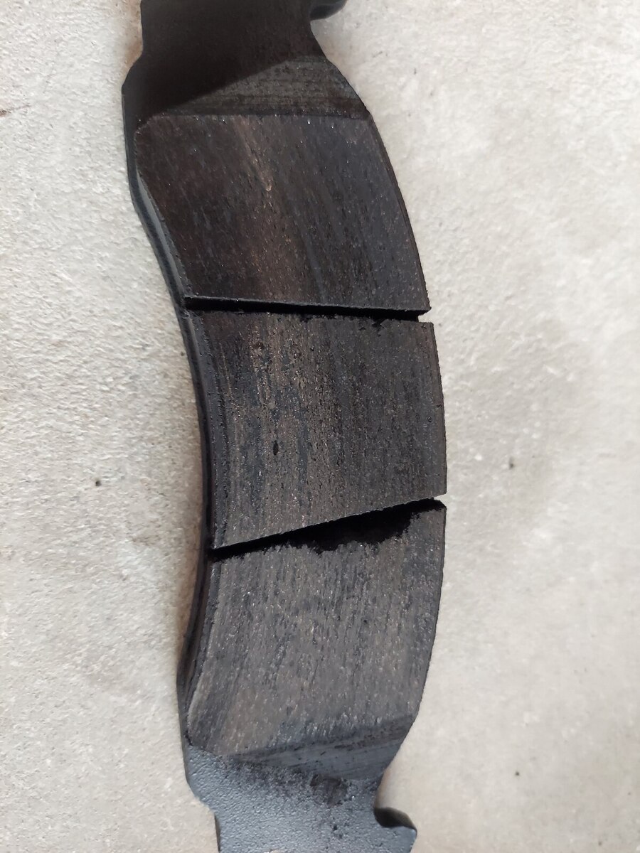

That is the real bad one on the right front. Here's the other two from the left front, this side wasn't having problems, but this was about to turn into one.
Those brake pads had 18 miles on them! I couldn't get a good pic of the missing bushing in the brake caliper bracket, my phone just wouldn't focus down the rubber boot.

whos pads are those? Duralast? regular or gold?
These were Duralast, but not the Gold. Rather unlike me to buy the cheaper set, but that was all they must have had at the time.
Excuses aside, I'd avoid these. We replaced them with Napa Premium pads, they seem to be quite a bit better.
