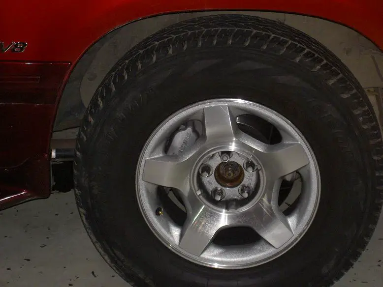

no chance of 16" fitting, they barley fit in 17"s
Gotcha, those calipers are either very large, or the rotors are closer to 14" big. My 12.75" rotors I chose to fit inside my OEM 16" wheels. Now I'll have 17's, but I don't really need more rotor, I have bigger calipers to adapt soon.
The Aviator brakes would be a feasible choice given 17" wheels or bigger. I wanted bigger pads also, so it gets more complicated.

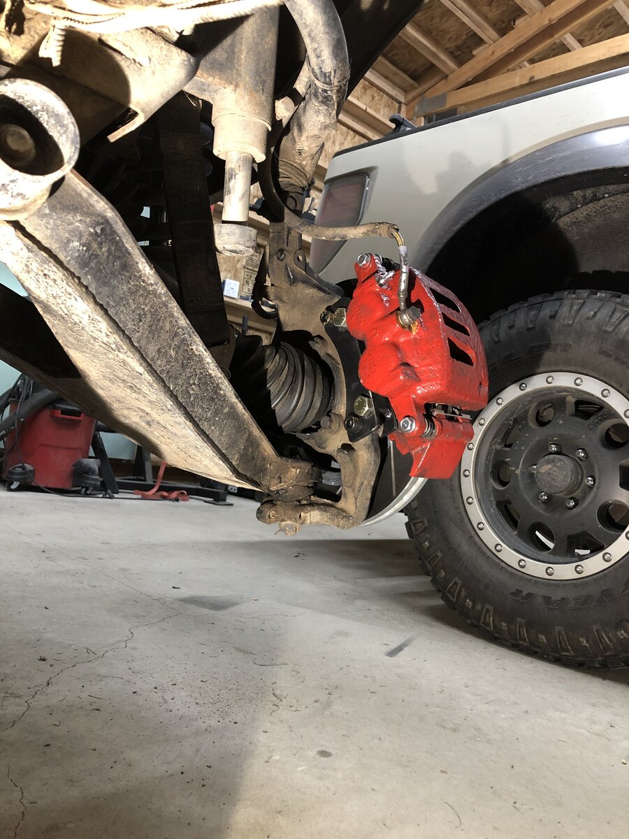

I am running the aviator caliper as well as the 13" rotor. the aviator caliper has larger pistons 48mm I believe and more pad surface area too. They are LARGE calipers and have a fairly beefy bracket. Hence the 17" wheels

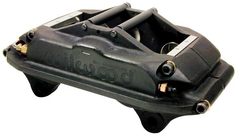

I saw that in your second picture, those calipers have a lot of meat above the pads, which is strength of course. I began with 65-82 Corvette calipers, and those have 1.875" pistons. They were a little big, but the pads were cheap and I swapped to SSBC calipers. Those I didn't know used non Corvette pads, from a Mitsubishi 2000 GT(smaller pads). Those don't last long enough, so I'll try the Wilwoods next, with 5.5sqin of pistons. Those will also be a little big, so a Ranger MC is my best choice to reduce front brake power a little. If the caliper pistons weren't so big, I'd go to the 01+ spindle and use a 13.75" rotor. That's too big though for these calipers, who knows what master cylinder that might require.
