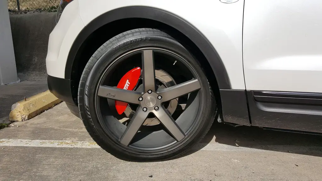

I felt the stock brakes on my 13 Sport were barely adequate w/ the standard 20" wheel. But when I installed 22"s it got absurd. So I upgraded to the
EBC® - Stage 9 Super Sleeper Slotted Rear Brake Kit
EBC® - Stage 9 Super Sleeper Slotted Front Brake Kit
The difference was night and day! Lots of power but still very linear feel. You will not regret it. Now when i get in other vehicles they seem to take FOREVER to slow down!
