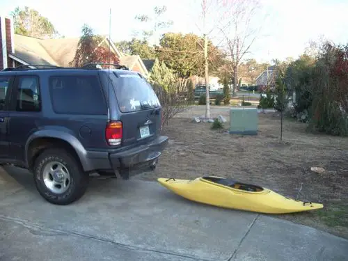

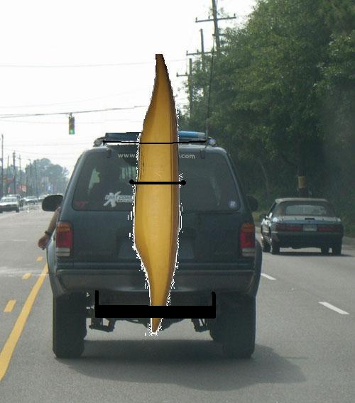

This thread is a prime example of what happens when engineering students get bored during finals week... I dreamed all this up about 3 AM while taking a study break.
Pic 1 shows my favorite activity in Charleston, SC

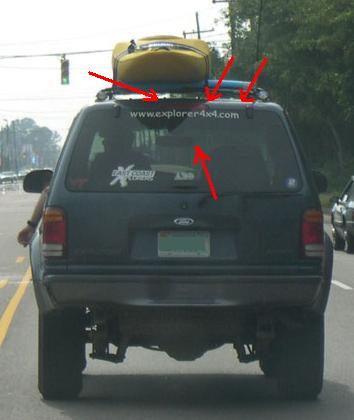

Pic 2 shows my old method of transportation to/from the beach *the arrows indicate locations of dents, dings, and scratches from loading the kayak on the roof for 5 months last year. (It also show's how badly I need to do an SOA mod for the rear, look at how low those friggin' shock mounts hang)
Pic 3 shows my (badly) photoshop'd (MSPaint) brainstorm

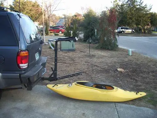

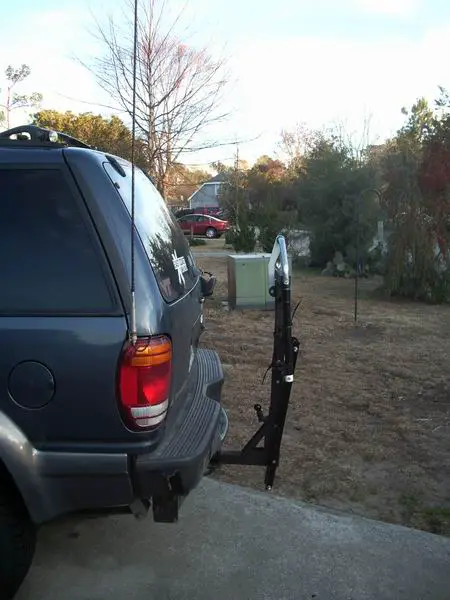

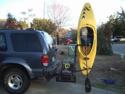

Pic 1... lets see here, how can this be done?

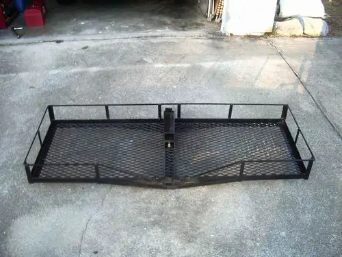

Pic 2... EUREKA, we have a solution. All it takes is one hitch mounted mtn bike rack, some scrap steel, a sawzall, a drill and a saturday afternoon (you can also see the anti-rattle hitch pin that I had to turn on a lathe at work to make everything quick release/lockable)
Pic 3... i think we're on to something!

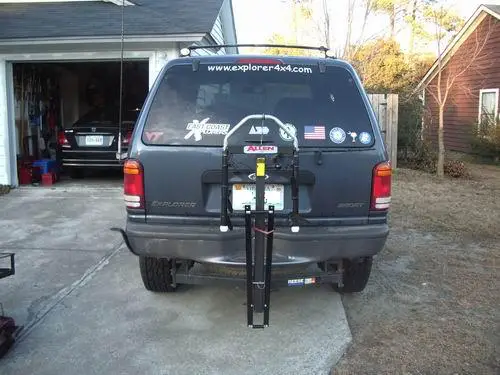

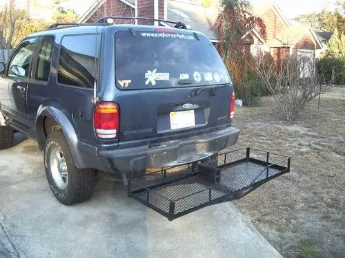

Pic 1 ... Houston, I think we've got it!
Pic 2 ... But wait, I have a hitch mounted cargo rack too...
Pic 3 ... Notice the auxilliary reciever I have bolted to the center of the rack

Pic 1 ... when there's a will there's a way :) Notice how the bike/kayak rack doesn't affect my cooler and grille carrying capacities :D Also, you can see the need for the next project ~ a paddle attachment
Pic 2/3 ... When not in use, it folds up nicely

Yeup, all in a hard day's work :D
I now can carry 2 coolers, or 1 cooler and 1 camping grille + my kayak + 1 bike. Now thats being prepared for one helluva weekend outing! :thumbsup:
I think these kayak's might be slightly too large ;)
