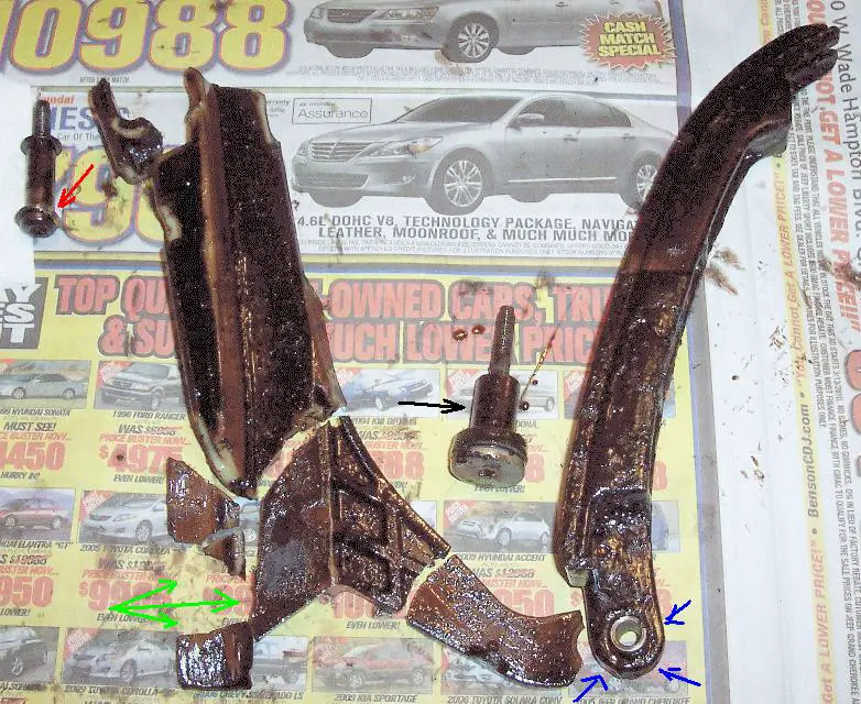

I removed my oil pan today to see if any plastic was there due to hearing a rattle from the TIming chain around 2300-2800 RPM. These are the pics of the plastic. Anybody have an idea what it broke from and if it needs to be replaced emediately or can go as it is?

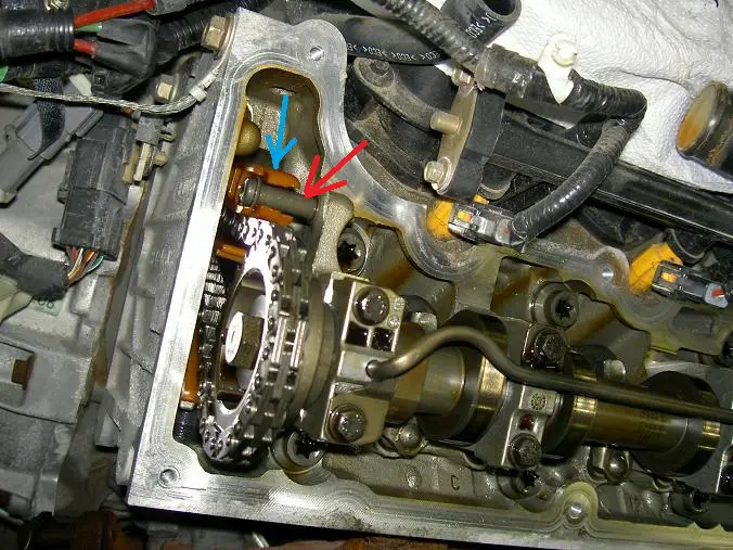

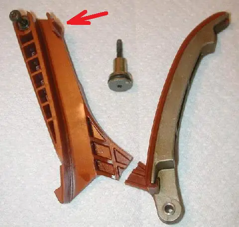

I agree with Tech By Trade. It's the piece at the top of the rear guide identified below.
There may be more pieces that didn't make it to the pan. My rear guide is shown below.
I finally found all of the larger pieces. Some were trapped in the head and the last one was behind the jackshaft rear sprocket. The following thread may be your next step: SOHC V6 Timing Chain Inspection & Repair
