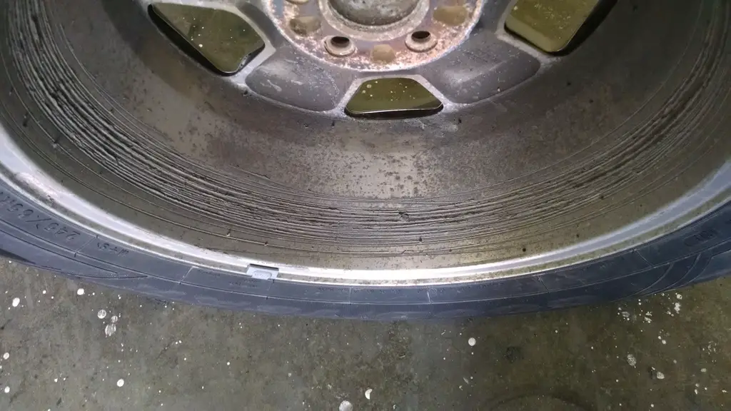

Noticed this scraping on the inside of the rim while I had it off:
Anybody have any idea what caused this to happen? Some moron at a tire store trying to mount a tire?
