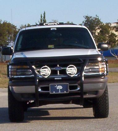

I like my Hella's 500's. They are bright enough for me.
That guy in the store if full of sh**. No way will 150 watts put out less light than 55 or 85 watts on the PIAAs.
Daylighters are too deep for any of my applications so I use the PIAA 80xt which is IMO just as good. Both are far superior to the 520 SMR. For the difference in price I would get the Hella 500s before the 520SMR.

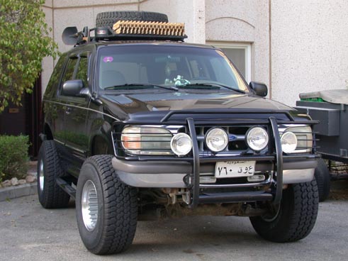

I'm running Hella 500, Hella 1000, Hella 181 & Hella Optilux. I feel that the 500's are nice but the 1000 make a differance. I like the amount of light with all 4 but the 1000's are noticible.
I don't know about the PIAA's but the Hella's work well for me.
I've been running them for about 4 years wired them up and haven't had a problem since. Work like the day I installed them & I've used them alot. Ran with all 4 sets at once for over an hour about 5 seperate times. Off-Roading looking for campsites in the middle of the desert.
