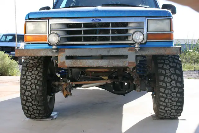

MANIAK, do you have any picks of the 250 brackets on your set up?
Here's 2 I could find.
shock-mount 002 by maniak_az, on Flickr
shot of drivers side front suspension by maniak_az, on Flickr

What year 250 would I snag them from? And do I snag the whole spring mount? Is the shock mount and spring mount all on piece?
