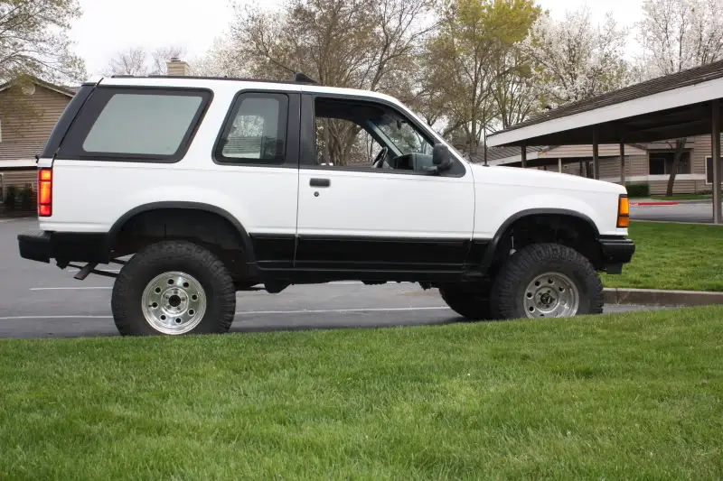

Well i have had my old ttb taking up space for a long time now, so i decided to do something with them.
my best friend bought my dads old 93 explorer a few months ago, so we are going to put them in his explorer if we get this all right.
so far we have the driver side beam cut and ready to be plated.
hear are some pics so far.
a little... too clean if you ask me...

Done!!!!!!!!!!!:)
clocked the diff on the beam, and no binding,:party: now we just need to go Wheeling. on with the pics

there was a slight bind in the driver side shaft. so we shaved a bit off the 3rd member and re drilled the beam.

It works!
hear is a teaser for you wile every thing loads.

...I would like to see this setup in person...and I'll have some ultra flat black paint for those bright shiny washers...:p:
LOL I really wish we could. I missed out on it last year to.I painted the washers already, got tired of looking at them being shiny.
so no binding issues at full lock?
i would like to get an extra set of beams and do a cut and turn like you did....just don't want to find out there are issues is all

nice work, do you have any more pictures of the passengers side arm?
Looks great, I like how you did it, seems easier but I havent read many threads about cutting and turning.
ahh whoops. i meant beam.
the one that the half shaft goes thru
we haven't had a chance to open it up yet, so it looks stock. :(
huh? you had to have modified the passengers side arm...or else your truck would be running lopsided...i see the cuts you made on the arm with the differential. but what about the other one? the one thats nearly all rectangular tubing that the passengers wheel attaches to the hub.
