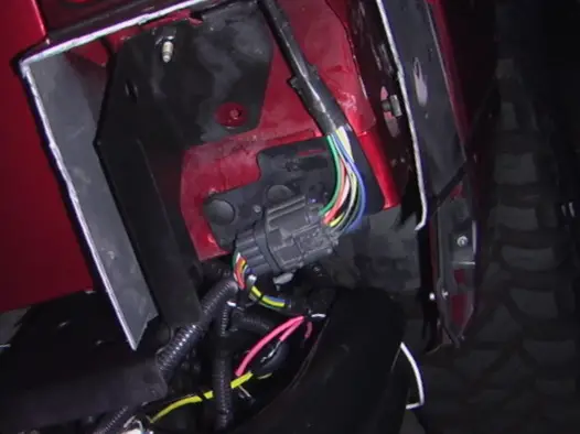

Ah! The brackets...
You are correct... These brackets here under the tail lamps, with the screw poking through, correct?
