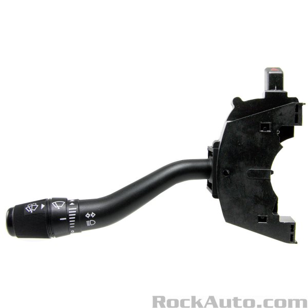

On my '97, when I activate the left turn signal, sometimes all I get is a buzzing from somewhere (under dash, engine compartment?). Only happens occasionally, and right turn signal appears normal. Is likeliest culprit a failing relay or the switch itself?

Failing Multi-Function Switch
Mine went out the same way - pretty common symptom before they outright break.
The turn signal portion of the part is pretty fragile - doesn't do well when forced to engage.

It could also be the connector for the multi function switch. When they get old sometimes they can get brittle and develop cracks, causing the wires to pull out of the connector

You can also take it apart and attempt repair. Put new grease on the contacts, sand them down. I repaired one on an old Ford, but it depends how much your time is worth :lol:
As forecast by others, the buzz came back. Bought a replacement multifunction switch (new) on eBay for $22.97, including shipping, installed it, and that was that. The Chinese switch probably won't last as long as the original, but it'll probably last longer than the engine.
Just did this to mine which started buzzing on the right turn signal.
It really wasn't any extra time. Once you have the assembly out, there's only 5 screws holding it together, T10 if I recall correctly.
Lay it flat when taking the screw-side cover off carefully and no parts will come flying out. Next I took a cotton swab with brasso (brass polish) and polished the contacts for a couple minutes, then came back with a clean cotton swab and dry paper towel and wiped remaining residue off.
Smeared a coat of dielectric grease on the contacts, put it back together, and 5 minutes later it was ready to put back in... probably less time than hunting down the best deal for a new one and ordering/tracking/receiving/inspecting it.
Before I had taken mine off, I mean a few months ago, I had taken the end cap and screw off, to take the rotating portion for the wiper speed off and clean grime off. At that point I had lost the detents (notchy feeling) for the wiper speed and couldn't figure out what happened.
Recently I figured that out. There is a spring with two brass end caps on it that is in the turn signal shaft right behind that rotating wiper speed adjustment ring. If you take the wiper speed ring off, odds are it will come flying out and I hadn't noticed that it did that. The spring and caps are perpendicular to the length of the turn signal stalk, across the diameter of it. They notch into molded sections on the inside diameter of the wiper speed adjustment ring.
One other tidbit I realized about pulling that multifunction switch out is that you don't have to take the lower dash trim panel off if you tilt the steering wheel down and are patient manipulating the cover pieces off and on. It doesn't speed the repair up a lot (couple minutes maybe) but does avoid getting down under the dash to work, everything else can be done standing next to the driver's seat.
This explanation makes my head hurt. :)

Anyway, back to my Explorer (which started this thread a long time ago): The cheapo aftermarket multifunction switch that I installed about six months ago is still working fine. And it has to last only 21 years to match the original ...

Once you get one of these open, it is pretty easy to see the green copper-corroded grease on the contacts. Brasso in particular (or any other metal polish with petroleum solvents in it) is good for this as it cuts through the old, hardened grease, and leaves a near mirror finish on the contacts.
Edit: Oops, I used the old school brasso in the metal can that had more petroleum solvents than the new formula in the gold plastic bottle. The new formula will require a bit more rubbing to get through the grease. [/edit]
I didn't need sandpaper at all, nor to clean all the old grease out, just that which was hardened on the contacts. The rest of the grease around the mechanism looked fine still.
What! You didn't use WD-40?
Actually, I had sprayed WD-40 into the old one, hoping it would fix things, which it did for a couple of days.
Anyway, I saved my old switch, so if the new one craps out prematurely, I'll try this repair. Thanks for posting!
^ A tiny bit of WD40 to cut through the old grease would work, but then an abrasive to clean the oxidized copper off. Brasso was just an all in one product that allowed me to not make a mess inside, take the hardened grease off with a cotton swab without flushing it down into the rest of the assembly, to leave the other non-contact grease intact.
That's not really necessary, you could take a toothbrush and gasoline to everything, then polish or sandpaper (I wouldn't use steel wool in case fragments got left behind) re-grease everything, then reassemble.
However if you get gasoline/etc in the stalk near the end with the washer/wiper switch assemblies, you'll want to re-grease those too.
