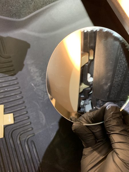

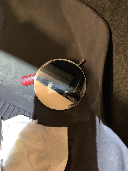

Consider using a headband style flashlight and an 8” diameter mirror to lay on the floorboard or hold onto so that you can see the pin during installation. Using the flashlight on your forehead will shine into the mirror and reflect up to the pin so you can see better.

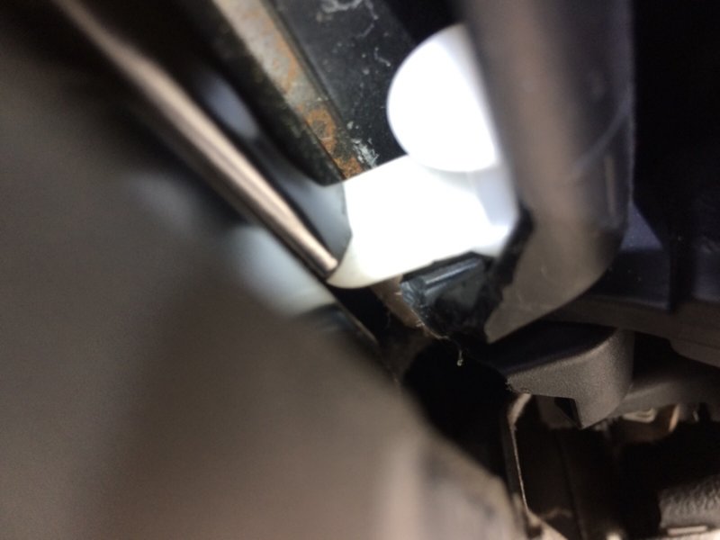

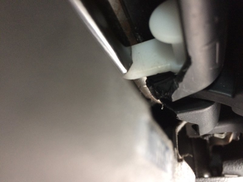

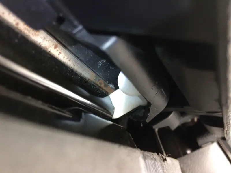

Please look at the attached photos (all the same part, slightly different views to help). Based on what I have read and viewed on YouTube DIY videos, I am not the only person to find this difficult/impossible. There are two white hinge locking pins on the bottom of the glove box door that are supposed to be removed. The first one, nearest the driver’s side slides toward the passenger door. This one came out with a bit of work. The second one, near the door? HA! The Ford engineer who did this must be laughing his head off!
This is supposed to slide toward the center of the car, but as you can see there is a piece of metal in the way. Why? How on earth am I supposed to get that pin out without breaking it?
I searched the forums and YouTube and watched a number of videos. No one has described this problem.
Any ideas? Or do I not need to remove the glove box door to change the cabin air filter?

I'll settle for what direction I need to rotate the pin. Since I tried and couldn't rotate it, I'm looking for some info from anyone that has run into this. I used a screwdriver and a hammer, and also needle-nosed pliers but the thing would not budge. I guess I can just break it, but I'd rather not. Seems some folks never replace the pins. Someone at Ford needs to be taken out back and beaten with a rubber hose.
Some have used a pair of pliers to grab the white pin...then rotate, then pull.
You do not need to remove the glove box door to replace cabin air filter. But, be careful that you don't let the glove box drop down too far or it will break the tabs on bottom.
With that said, I found it easier to pop the pins out by dropping the knee air bag out of the way. It's 4 screws and very easy to take out, then the pins just pop right out. Hard to tell exactly from the above pic, but it looks like the pins are being held in by the air bag.
You need to rotate the tabs on the pins down to where you can then slide the pins out.
I tried this, and the pin would not budge. I will give it another go. Maybe I could smack it a bit harder.

I just used a screwdriver to move the tab down and then used it to pull the pins towards the center.
It was easier to use the screwdriver than my fingers.

I still cannot budge this pin. The white tab that looks like it should swing down is either caught on something or wedged in. I got a screwdriver behind it, but I could not rotate it down. Also got some needle-nosed pliers on it and could not pull it down.

I don't remember just how tight mine were but a screwdriver blade prying a little did the trick to get that tab to rotate down.
