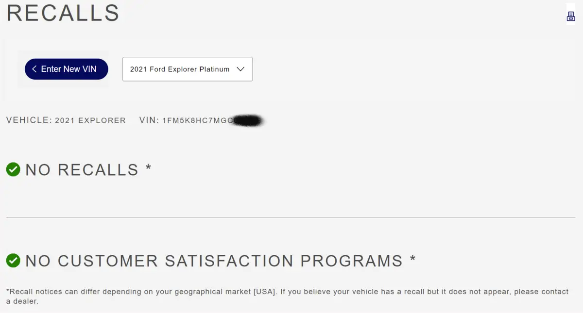

UPDATE:
A federal representative from NHSTA called me to discuss this today and ask some additional questions. He indicated that from everything he read my vehicle should be included in the recall. He promised to get back to me within a week. More to follow.
Latest update on my 2021 Platinum built during the affected time period - Ford and NHSTA - it is not covered by the safety recall or customer satisfaction program
Nor is my King Ranch but we are the 365 HP versions vs the 400 HP versions (sadly in my case) so maybe that's the threshold?

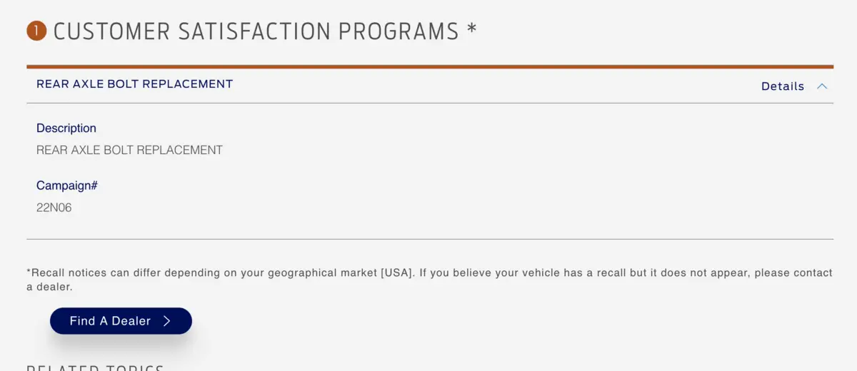

Hey, has anyone looked into an upgraded stronger tensile strength bolt to replace it with?
Just got my Explorer ST back from the dealer on Tuesday after the axle bolt broke. It was in since the end of October waiting on parts that were on back order nationwide.
I had ordered the ID Speed axle brace on black Friday since that brace is so damn expensive. Had it installed today for extra security for the bolt and the mechanic said he loosened the bolt to make room to get another one in on the brace and the axle bolt seemed bent already. It was only installed for two days. I haven't brake boosted/power braked it since I got it back. I've only done a few quick take offs with just stomping the gas so it shouldn't of taken that much abuse in the 2 days I've had it. Definitely shouldn't be bent already. Ford doesn't have the parts readily available to fix it so if it happens again it could be months especially if more people are breaking now.
If anyone knows a specific part number to a stronger bolt or provide a link to order one if anyone has looked into it yet please post it. Thanks
Did he remove the bolt to see if it was bent? If not it could be some other reason.
Said he loosened it enough that as he was turning it he could tell it was bent. Didn't wanna take it all the way out and not be able to get it back in. Not sure if I should bring it back to Ford again or just buy a stronger bolt and put it in.
I would go back to Ford and see what they say. The chance of finding a stronger bolt are pretty slim. Plus that may not help.
The ID Speed diff brace uses new bolts on the axle cover and the tensile strength is supposed to be greater making for a much stronger bolt. They advertise the bolts used in the whole kit are a stronger metal so there's a good chance that a bolt with same length and threads could be used on something else completely and be a stronger metal and be used on the axle. Or maybe an aftermarket company could make one as I'm sure many people would buy them
Well I went into Ford today and the tech said it's definitely bent. He said Ford claims it's an upgraded bolt that they use in place of the old one on the recall. They ordered another one as they don't have any. So now I wait and drive easy on it so it doesn't break again.
I wonder how many of you are driving with it bent already and just don't know. If you always drive easy I'm sure it's fine but for the people who drive aggressively and launch it off the line quickly I bet a bunch are bent at the minimum. If anyone can check do so that way Ford can fix it before it becomes a problem and maybe notify the NHSTA. That way Ford an implement a proper fix so we don't have this issue anymore.
The way the mechanic noticed without taking out the bolt fully was as he was loosening it he could see the bolt going up and down inside the grommet.
