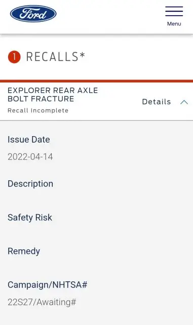

I read on the ST forum that some members are seeing a recall for a Rear Axle Bolt Fracture.
No other information is available at this time.
My '21 Platinum V6 has no recall notice listed on the Ford website.
Here's information a member posted on their website.
I don't think it is a good sign that they are calling it "bolt fracture" instead of the real reason:. built with the wrong subframe
Reading further on the ExplorerST forum it appears many vehicles are affected.
Here's the information posted there. I wholeheartedly recommend you read it thoroughly.
I for one will be using the parking brake from now on.
