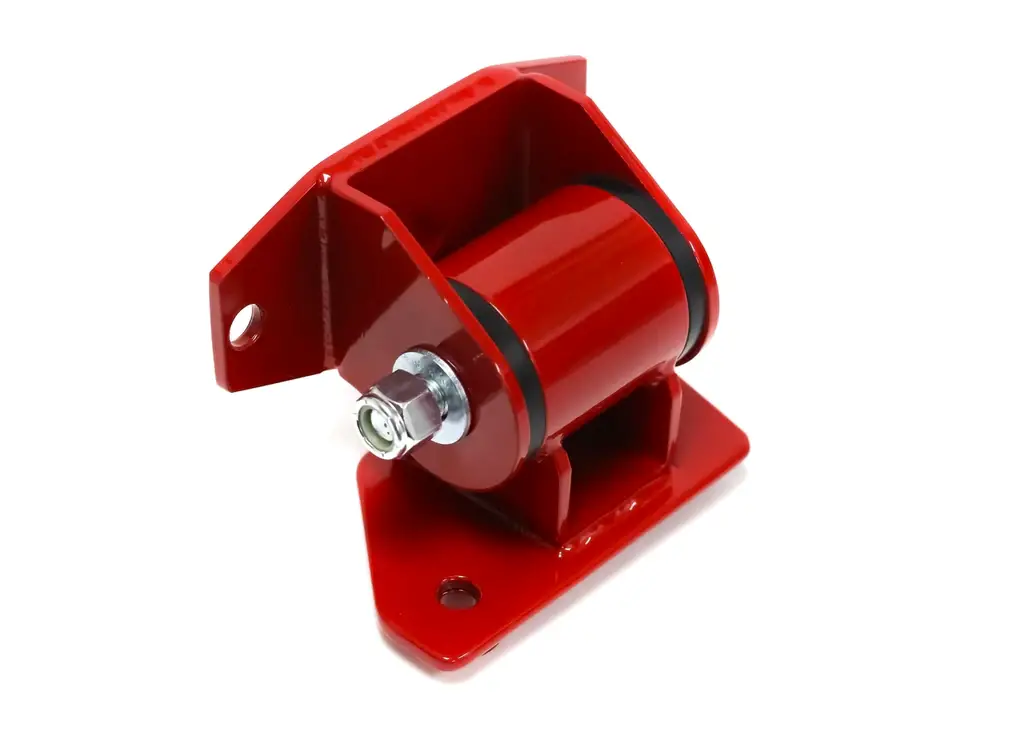

Can you show/tell how you installed it? The company says it can be installed without jacking up the vehicle.
Here is the video of Whoosh installing one. You can see he is laying on his back doing it.
