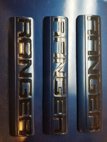

Personally I hate it when threads never reach their conclusion. I intended to wrap this up when the emblems are on the truck.
I didnt have any issues using duplicolor gloss clear coat over single stage. Removing the liquid mask after paint and clear was what made me go to a pro.
The last attempt turned out awesome.... 10 min after they had all been painted and cleared I began to remove the masking, some of the paint and clear pulled up with with the liquid mask.... DOE!!!
This is when I decided I was either going to use the ranger emblem paul shared,
or have them done by a professional. I went with the later. I was disappointed I didnt finish, but relieved they were done.
I used a hot rod shop, Extreme Metal and Paint in Anacortes,Wa. They were great, but they had difficulty with them as well. I dont have an image to share of the professional emblems till they are on the truck, but I can show how close to perfect i was.
I didnt clean up the paint from the edges of the letters, I just put them away for later when I wasnt as upset. Lol
If you look at the R on the lower right you can see the paint peeled. I left them as is, but after seeing mine next to the pro I am confident I can fix and finish these if needed. My paint and clear was smooth and I put enough clear on to be able to polish them to a high gloss finish.
In the end I came to the same conclusion as another member who attempted his own variation as well. By the time I bought paint, supplies, and emblems, plus my time, It cost nearly as much as it did to have a shop do them.
In conclusion, unless you're already a experienced painter or a masochistic, just have a shop make them for you.
I'm not saying it wasnt fun, I did learn a lot and gained confidence in my own abilities. Had I not had a shop paint a set I would have assumed I was just a lowsey painter. Seeing them side by side showed me that they are tough even for a pro. But now I know I can do them just as well and I can fix the ones I have or do a new set from start to finish and get it right the first time!
Here one more shot of one of my emblems
Heres the peeling
I bet most would never notice if I installed these on the truck but I'm picky. Lol.
