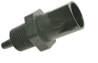

I don't know. Maybe it's the wrong sensor. Mine looks like this and is from the ford dealer:
Yeah, that's what mine looks like. It seems like Ford used that sensor for several models over several years. This XLS is about as stripped down as I've seen a vehicle in years. Have decided to add a Gentex mirror with temp, compass and homelink.
