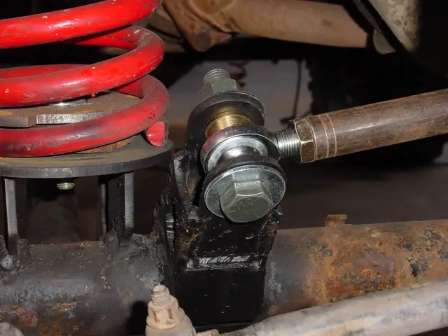

Yes street driven , and I am using heims anyway.
I drove a truck 2000 miles on the highway that used smaller ones. They seem easier to replace also.
I see no way to shorten the bolt with mis alignment shims. I could use standard shims, but this would stress the joint, increasing it's likely hood to fail. Those are 3/4" grade 8 bolts.
