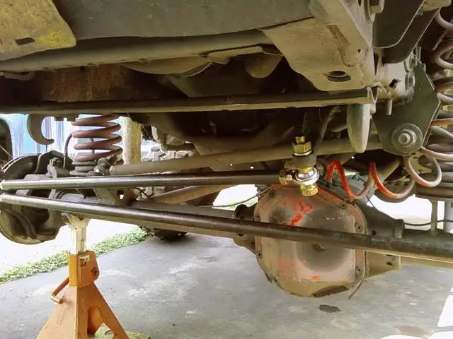

Here is mine. I have a 1" bolt on the drivers side, a 2" bolt on the pitman and a 3" bolt on the passenger side. the drag link and the tierod are above the knuckle mount. I've had no problems so far with my set-up. I did have to flip the pitman location because the bolt head was hitting the tierod when flexing.

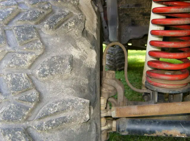

I have the misalignment spacers on.
this is the misalignment spacer I used. Not real tall but works nice.
Ok my drag link ends are true 7/8" bore and rod, with high mis-alignmet shims reducing to 3/4". The remaining ends are 7/8" rod with 3/4" bore.
you cannot get a high misalignment bushing that does not decrease the bore diameter. Standard bushings would not give me the angles I needed, and, these are the only high mis bushings that will work with this end.
I dont see a problem - just check them every now and then, cary a spare bolt (and wrenches), and maybe even go as far as to replace them after every couple of runs (bolts are cheap).
OK, a little mixed up. What diameter bolts do you have passing through the heims on drag bar?
