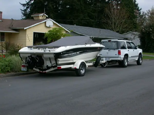

Definately get extra tranny coolers (I run 2 auxillary coolers) This 185 Sport and trailer are around 3500lbs.
I put the X in 4L to pull it out of the water. It pops right out! :D
