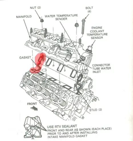

hey guys, the 95 has a pretty decent coolant leak, its not the hoses or the rad. itself, i cant find where its coming from. there is steam coming from somewhere, maybe its running onto exhaust? but anyway the steam comes up from the drivers side between brake booster and drivers side manifold, cant identify wheres its coming from, any ideas? someone told me freeze plug possible, but i just read that u gotta pull the engine which costs like 1000 bucks, it dont leak at a steady rate but every day or two u gotta refill the overflow tank. it doesnt steam all the time, usually after u drive it somewhere, i had to drive couple time around block for it to steam, wont do it at just an idle, thanks for the help
Anythings possibe, steam usually means exhaust manifold, which means head gasket most likely with pinhole leaks quirting on to the manifold from anywhere possible also. Freeze plugs are below and can be accessed without yanking engine.. Get yourself a coont system pressure tester loaner from autozone or wherever and look for the leak.

ya i really hope its not a freeze plug, where are the freeze plugs in relation to exhaust manifold? could they leak from there and hit manifold? or is it more likely head gasket?
looks like head gasket. Don't you have problems with warming up the engine ? Sometimes there is impossible to warm theengine up when the head gasket is shot

well i had ford dealer look at it, they said they pressure tested it, both head gaskets are leaking, luckily the coolant did not leak into the engine only externally, so no internal engine damage, just have to have the gaskets replaced, someone give me a rough estimate on cost? i think im getting screwed on the price, gave me a estimate like 10 times what i thought it would be lol

I had a somewhat similar problem. I would be sure they checked the heads. There's a thermostat housing (plastic) on the top front which has sensors embedded. This developed a leak and the coolant ran down the lifter valley and off the back of the motor, driver side. It's serviced as a unit.
