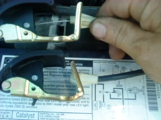

Mine did the same thing and after 2 times of having issues a pulled a good one from the junk yard and put them side by side. This is what I saw. Notice the bend in the mount. It's the mount on under the dash that was bent, maybe some cable stretch, but the mount being bent wouldn't pull far enough.
Try This....... Hold The Cable upwards toward the steering column while pulling the lever and see if it keeps the mount straight.
Hold the applause. Thank You
