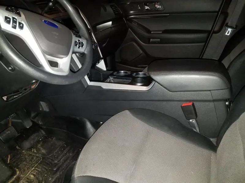

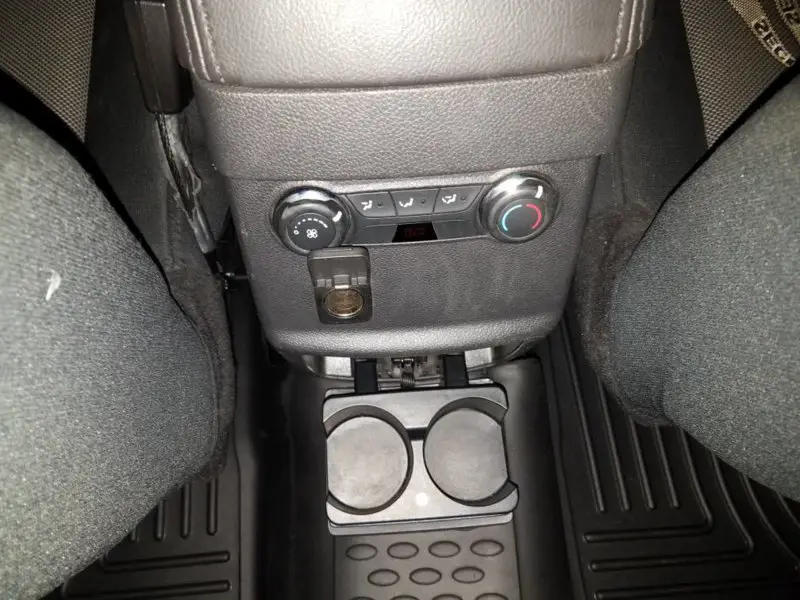

Or, I don't know. You could buy and add the correct console from any number of retailers instead of half ass-ing it.
Meh. Seems like alot of money, time, and effort. Also I would have to relocated my aux and USB inputs for my sync radio, as well as my 12v plugs. No thanks, this one is perfectly functional, has more storage than the factory unit, and doesnt have gaping holes where non-existent equipment goes.

Probably best you actually do your research.
Considering i dont give two flips about throwing the actual center console in there, my time, money, and effort are spent on other things. Worry about yourself.
