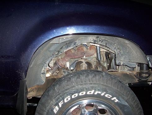

just changed my spark plugs and wires due to rough idling, VERY POOR gas mileage (6mpg - no, sadly, im not joking), and very frequent missing. The overall procedure took much less time than originally anticipated - I had figured about 2 hours, since I had heard some horror stories about that last plug, but it took about 15 mins total, including time to jack up and remove my passenger side wheel. When I removed the old Bosch plugs, I noticed that they had a significant amount of white almost powdery buildup on them, and this resulted in a gap of about .010 inches as opposed to the 0.054 that I gapped the new plugs to. What causes this buildup? Is this just normal wear? Or this is a sign of an engine malfunction? I checked my Haynes manual and I didn't see my symptoms listed in their little diagram of spark plug indicators.
Also, a few tips when changing plugs - a pair of vice grips will pull those wire boots right off, and when trying to get at the plugs on the passengers side, a 3/8" ratchet with a 2 ft piece of 1/2" EMT(conduit) works wonders in allowing you a good grip to loosen and tighten the plugs.
